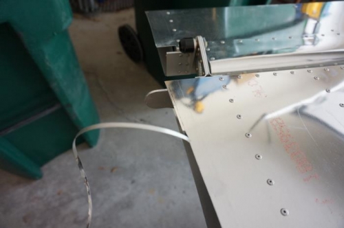

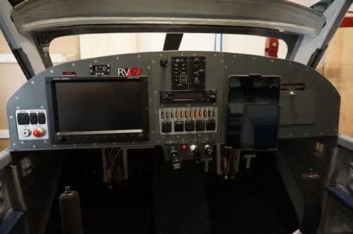

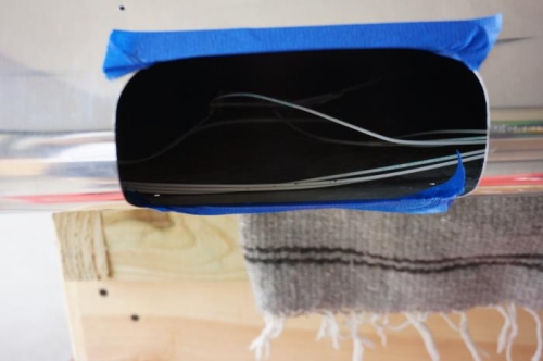

Placards installed per Van's instructions. Wings removed from rack and inboard ends trimmed to specifed 3/16 inch gap from fuselage, allowing gap seal to be installed between wing and fuselage. Holes for landing light and associated support brackets drilled/cut in right wing leading edge using paper template. Unfortunately landing light lens does not have same curved shape as leading edge.
Placards
Placards
Trimming inboard edge of wing skins
Landing light
Landing light
