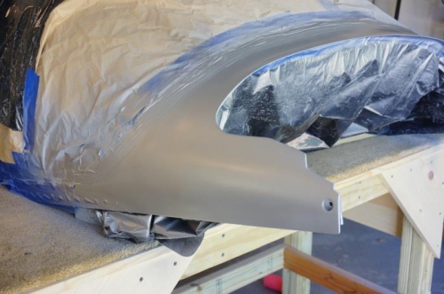

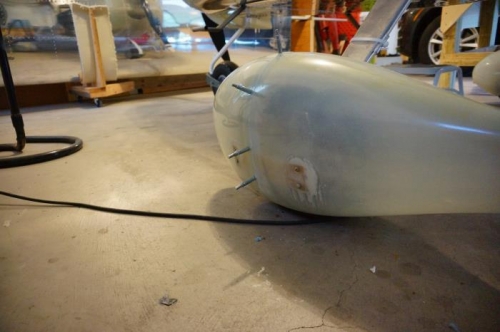

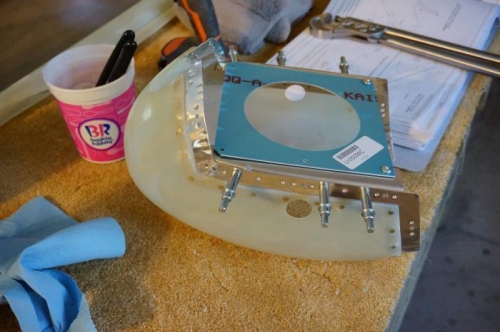

Canopy fairing paint dry, removed all masking in preparation for attaching to fuselage. Next, worked on wheel fairings, including addition of resin/flox mixture around fairing attach bracket on main gear. Similar resin/flox mixture used to attach nose wheel fairing fore and aft bracket (along with rivets). It appears next set of rivets cannot be set with a hand squeezer.... will need some thought.
Final painted fairing
Nose wheel fairing
Nose wheel fairing
Fiberglass/flox mixture added around attach brackets
