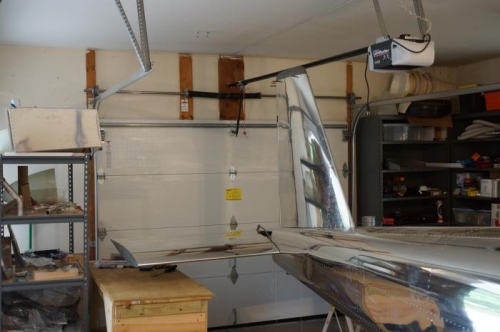

Brief Description:  Empennage installation

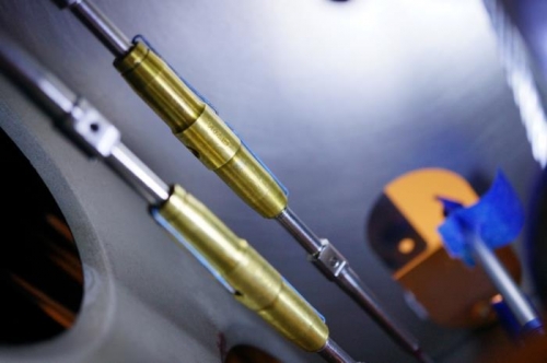

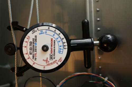

Attached vertical stabilizer and rudder. Installed stabilator. Final routing of cables, attached stabilator end fittings and set cable tension to 40 lbs. Inserted locking clips. very tight working space! Installed rudder pedal rigging stop and measured/drilled rudder cable fittings. Finally looks more like an airplane than a boat!
Empennage installed
Empennage installed
Stabilator cable tension
Stabilator locking clips
