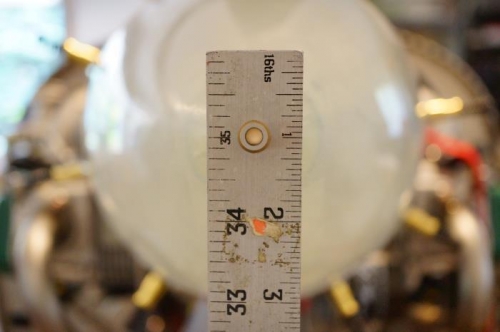

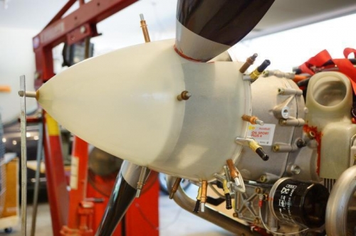

Removed cowl and old spinner. Deburred and prepped new spinner components. Set fuselage on sawhorse to avoid any movement when aligning spinner. Installed prop and reassembled new spinner. Spent the better part of an hour convincing myself the spinner was aligned, and there was no pitot tube movement. When comfortable, clamped spinner in place using all available clamps, drilled and clecoed.
Pitot through hole with 1/32 inch clearance
Clamped and clecoed
Clamped and clecoed
