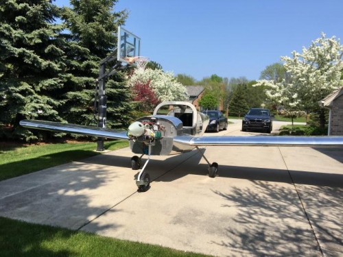

Brief Description:  Wing attachment
Prepared for wing attachment and final flaperon link assembly. Inserted wings but unable to insert wing pins due to apparent hangup of spars. Called Vans who suggested main spar is most likely, and to check for rivets or edges that might be hanging up spar. Nice to see 12BB with wings on!
