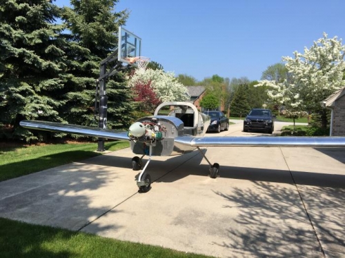

Brief Description:  Fitting of wings
Initial installation of wings. Planned on drilling flaperon linkages, but unable due to inability to fully insert wing pins. Called Van's regarding potentail areas of hangup and was advised most likely wing spar. Will reinsert with careful attention to any rivets or other potential obstructions. Looks good with the wings on!
