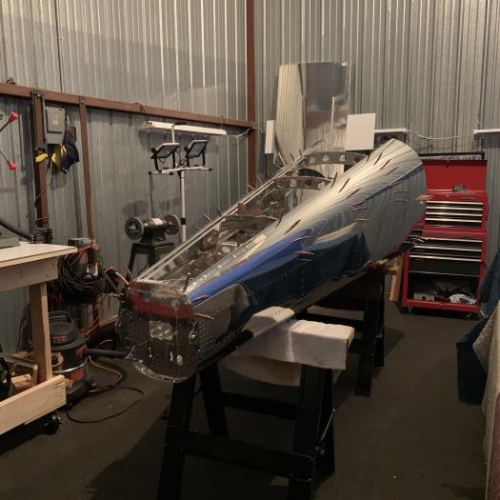

Brief Description:  Rear bulkhead and tail cone

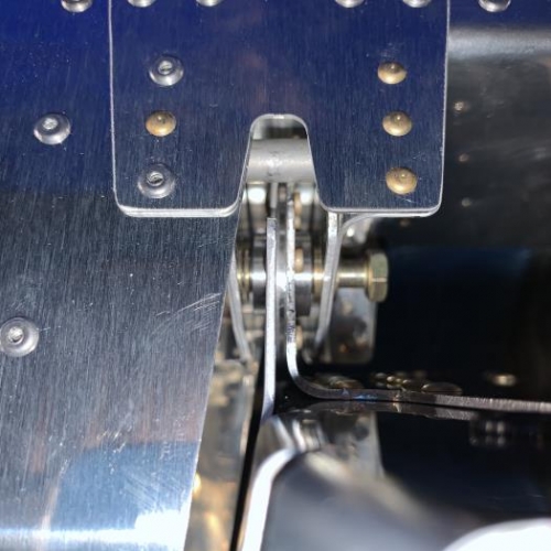

After completing the rebuild of the rear bulkhead, it was attached to the stabilator using hardware called out in the KAI. Fit was achieved using 4 -416L washers as spacers. Washers were then glued in place.

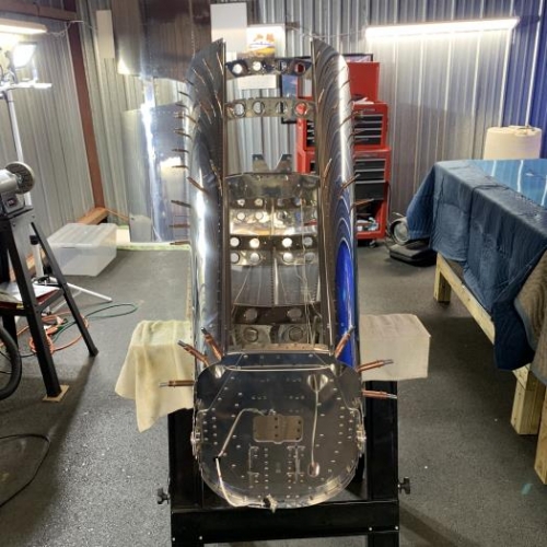

The rear bulkhead was then installed into the tailcone. Trim servo wires and strings to pull through stabilator and rudder cables were routed and side panels riveted in place.
Fitting rear bulkhead to stabilator
