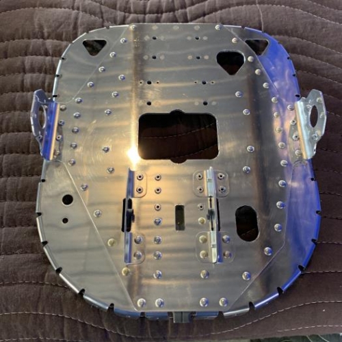

Rear bulkhead

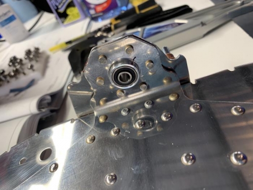

Deburred and riveted rear bulkhead. Two solid rivets could not be reached with my 3" yoke and were replaced with Cherry Max CR rivets per MMr3.1 p377 ("Cherry Max CR series rivets may be substituted for any AN470AD rivet or LP4 rivet.") See Image 2.
