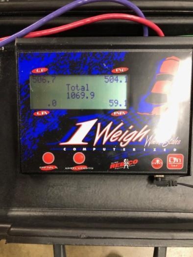

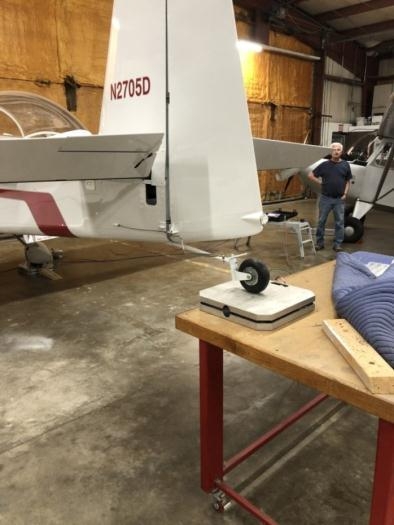

There was 1 gallon of fuel in each wing, the weight and moment had to be subtracted out
Empty Aircraft
Weight Arm Moment
Right Wheel------------ 498.40--- 68.37----- 34075.61
Left Whee--------------- 501.20--- 68.37----- 34267.04
Tailwheel---------------- 58.20--- 251.5----- 14637.30
Total-----------------------1057.80------------------ 82979.95
CG-------------------------- 78.45
