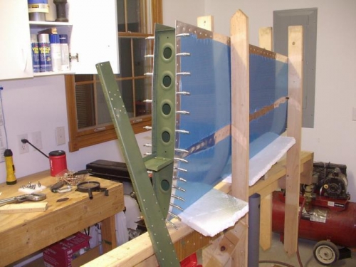

Clecoed the VS-803PP to VS-808PP, VS-410PP, VS-411PP and VS-412PP together.
Rivet the rear spar together remembering the flush rivets on the lower rear spar.
Rivet VS-704, VS-705, VS-706 and VS-707 ribs to the front spar.
Cleco on the VS-801PP / VS-901 skin.
Rivet on the skin. Begin at the intersection of VS-707 and VS-702 and work towards the tip, then restart at the same place and rivet along the front spar toward the root and along the VS-707 rib starting at the front and riveting toward the rear spar.

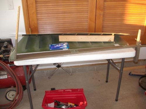

Clecoed on the rear spar assembly and install the remaining rivets along the rear spar and end ribs with a squeezer.
Blind rivet the rear spar assembly to VS-707
