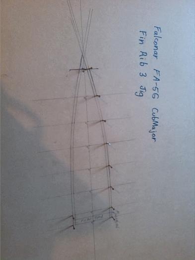

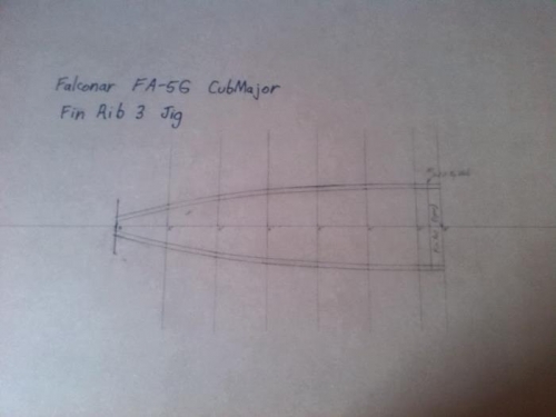

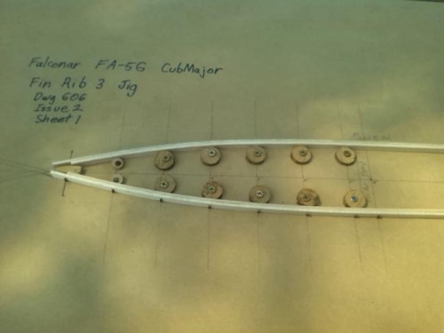

Brief Description:  Jig for Fin Rib 3
Finally finished work on the first of many rib jigs.
The jig has a trial dummy run of Balsa wood rib stock in it.
Looks good, should work well with Sitka Spruce in it when I finally get my hands on some.
I used the outline of the Balsa Wood to make a rib plywood web marking out template.
Ready to move on to the next jig while I wait for some real aircraft building timber.
Outline drawn
Outline drawn

Trial run
Trial run
