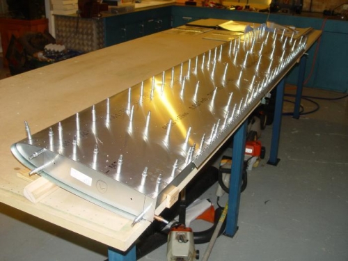

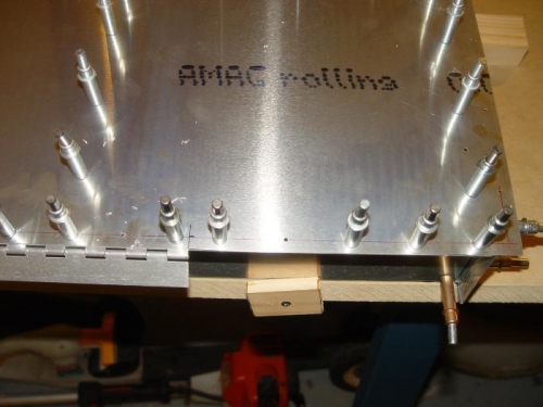

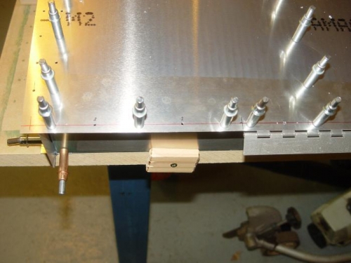

Marked the elevator hinge tab centre line, transferred the centre line position onto the stabiliser, marked out the rivet positioning, then drilled and clecoed the elevator hinge and rear spar rivet line.
All work was carried out in accordance with the Zenith Aircraft Company Construction Standards 2007, Zenith Aircraft Company Photo Assembly Guide 2008 and the Zenith Aircraft Company Plan Set Serial Number 65-7512.
Stabiliser with elevator hinge clecoed in place
View from the left rear
View from the right rear
