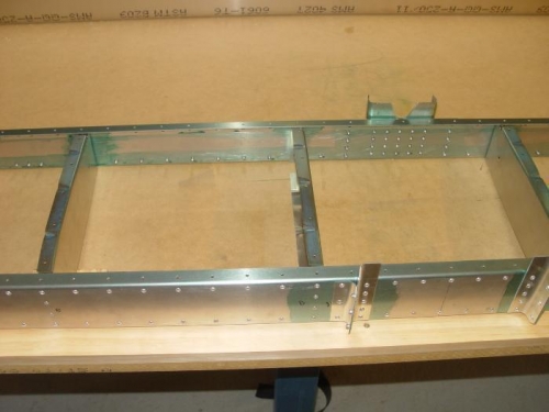

Removed the stabiliser skin, deburred the skin and skeleton, cleaned the skin and skeleton mating surfaces and applied Cortec to the skin and skeleton.
All work was carried out in accordance with the Zenith Aircraft Company Construction Standards 2007, Zenith Aircraft Company Photo Assembly Guide 2008 and the Zenith Aircraft Company Plan Set Serial Number 65-7512.

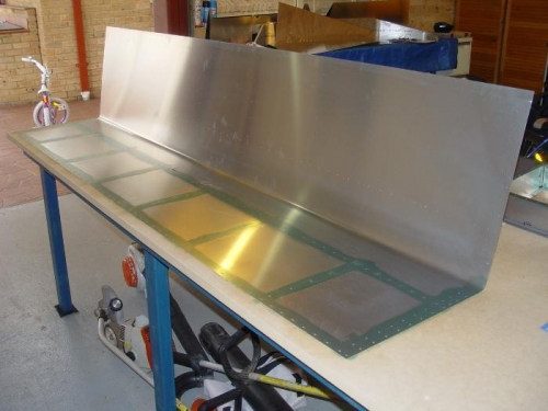

Skin cleaned, Cortec applied

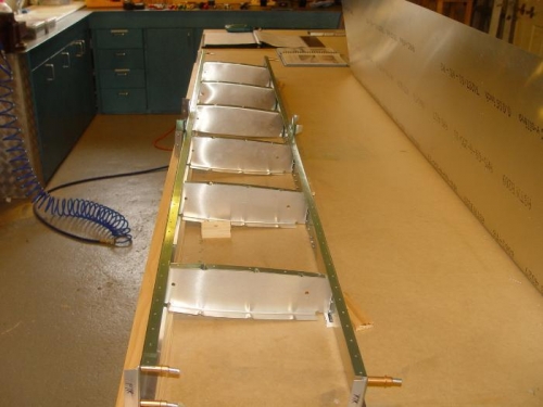

Skeleton cleaned, Cortec applied
