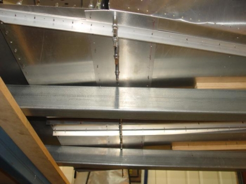

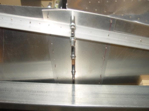

Tonight I removed the centre wing spar, marked the rivet lines on the cabin floor doubler, installed the cabin floor doubler and back drilled through the cabin floor into the doubler. I then marked the rivet positions on the front of the doubler, removed the doubler and drilled the #40 pilot holes. I next re-installed the doubler and back drilled from underneath through the cabin floor. The centre wing spar was then re-installed.

Cabin floor doubler from underneath

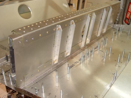

Doubler rivet line in front of the spar
