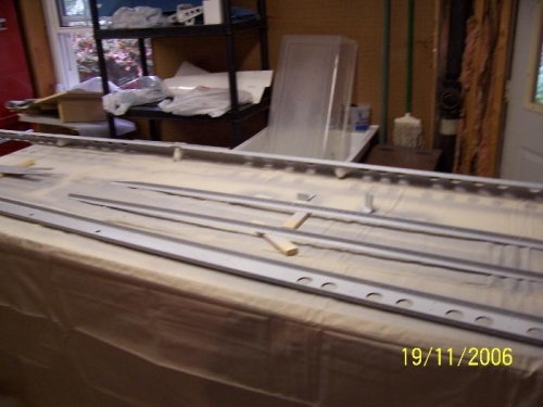

Brief Description:  Diassembled, prepped, and primed parts
Tore everything down, Sanchem'd them and then primed. Results weren't bad this time. The Sanchem went on better as I used distilled water to rinse and was genrerous with the part "C" acid during the prep. I got a better color change as a result. The spraying went terrific. The canvas drop cloth was a wise investment.
Primed parts
Primed parts
