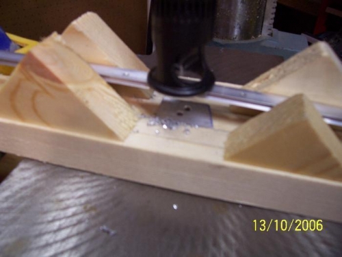

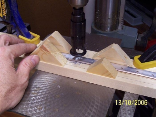

Only did one step tonight but it took some time to setup. The job tonight was CSK the AEX wedge. Researched the task online a found a couple of different ways to do it. Based upon my previous experience with small aprts (the striker plates), I decided to go the drill press route for mounting the microstop to keep it perpendicular to the work. This methoud requires you to build a jig to hold the surface to be CSK's horizontal. Problem is the AEX wedge is just that a wedge so a jig is in order to offset the wedge so that it lays horizontal. I made made mine with scrap wood and the only scrap pieace od VA140 I had (what was left form triming the trailing edge to length). Glued to all togther and it worked like champ. The rudder is now ready for priming.
Trailiong edge CSK jig

Trailing edge CSK in action
