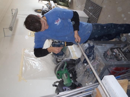

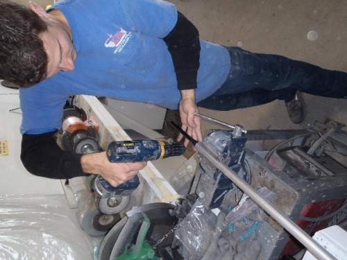

Fabricated push pull tubes
Fabricated push pull tubes by cutting aluminum tubes to length and installing endcaps with cherrymax rivets and hysol. Push pull tubes to be powder coated before final installation
