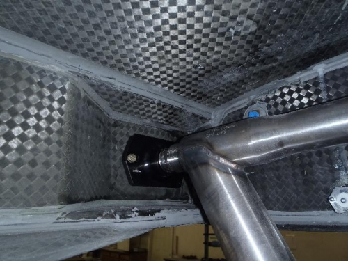

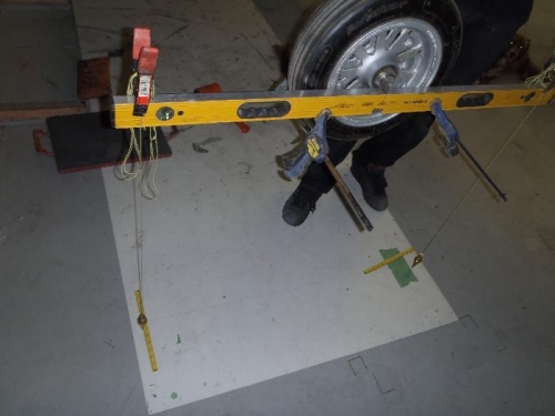

Lifted airplane for landing gear clearance. Leveled airplane fore and aft, left and right. Ran a chalk line on the floor plum with aircraft centerline. Put landing gear Toe template on chalk line. Installed landing gear in trunnion blocks, still loose from when they were installed in wing last week. Installed level on wheel, put two plumb bobs on each end of the level. Measured difference on the template and adjusted trunnion blocks until proper toe was obtained. Torqued trunnion blocks, drilled remaining holes and installed hardware.
level with two plumb bobs on template
