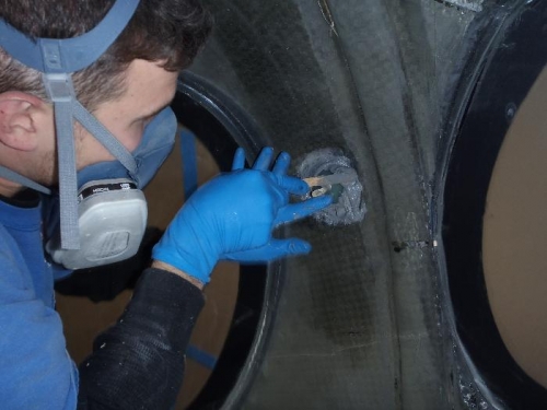

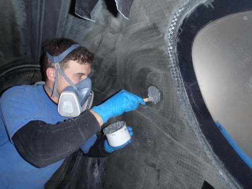

seatbelt mounting
Removed outer skin and decored where seatbelts are to be mounted,. Prepped all surfaces. filled cored with hysol to make a hard point, Then installed mounts with hysol, taped to secure until cured.. 4 Bid carbon fiber layup installed after cure.
