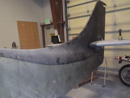

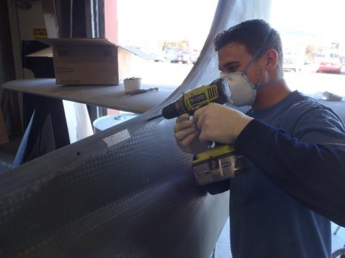

Tail Modification Prep
Drilled vent holes in vertical stabilizer to vent the tail modification. Dry fit Tail mod, trimmed and fit where required, drilled kleeko holes for alighnment. Prepped bond surfaces, and cleaned with acetone.
vent holes
dry fit
