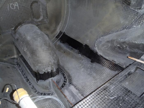

Date:  10-17-2011
Number of Hours:  7.00
Brief Description:  Forward floor structure
Match drilled floor support rails to floor structure, installed 10-32 nutplates in rails. Bolted floors to rails with AN3 bolts. Dry fit floor in forward fuselage, trimmed and sanded as required. Prepped both surfaces for bonding. Wet out both sides with straght resin. Mixed resin and Flox for build up. Built up mating surfaces with resin mixture. Installed floor structure level. Cleaned excess.
fuselage structure prepped
floor structure prepped and built up with resin
bonding floor in
