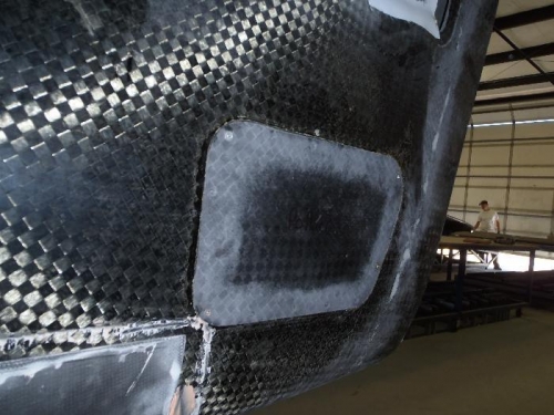

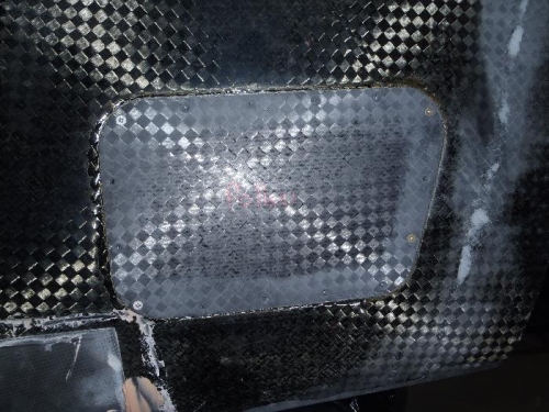

Drilled holes in left rear fuselage access panel, matched holes to fuselage joggle. Counter sunk holes in panel. Installed nut plates in fuselage with countersunk solid rivets. Installed access panel.
