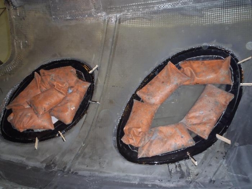

Date:  8-30-2011
Number of Hours:  7.00
Brief Description:  bond windows

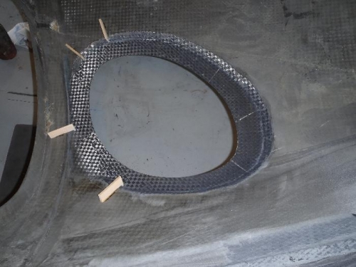

Prepped and cleaned window mating surfaces. Rotated fuselage to make gravity our friend. Dry fit windows and installed alignment blocks. Cleaned surfaces. Applied adhesion promoter to window surface. Mixed B1/2 PRC . Applied thin "wetout" layer on windows and carbon . Then applied heavy PRC bead on carbon side. Installed windows, applied lead shot bags for weight. Formed a PRC radius along inside edges.
