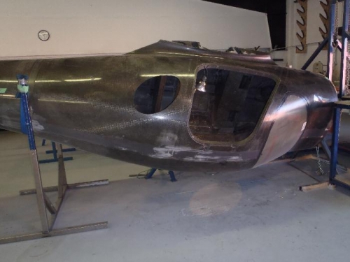

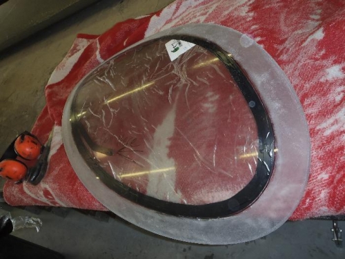

Rotated Fuselage to right side down. Laid Windows in and measured for prep areas. Prepped right side windows by making beveled edges and sanding pro seal contact area.... Rotated fuselage for left side window. Measured window for prep areas. Prepped left window by making beveled edges and sanding for pro seal contact area.
lay fuselage on its side
prepped window radius's
