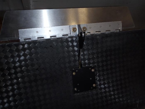

Fabricated aileron trim tab from .060 aluminum. Installed hinge with countersink rivets. Installed trim servo in aileron, trimmed aileron for trim rod clearance. Installed bracket on trom tab hinge. Cut rod to size, connected rod end to bracket.

tab and servo final install.
