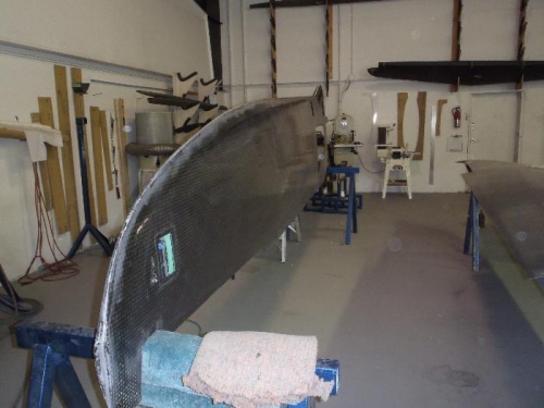

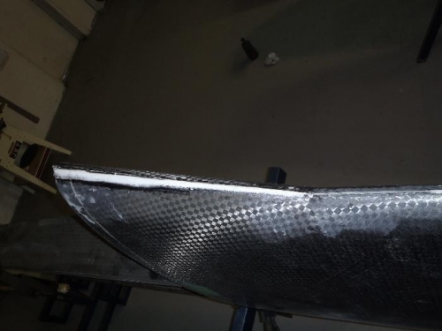

Sanded and prepped right wing leading edge. Filled voids with resin and fillers. once cured applied 2 ply carbon fiber lay-up w/peel ply.
layed wing leading edge up
filled voids with resin/filler
applied 2 ply layup
