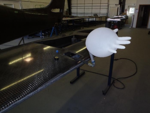

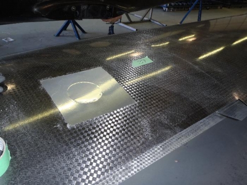

Sealed tank filler neck with aluminum tape. capped all fuel fittings and drains. Hook up pressure gauge. Pressurized tank with 2 to 3 PSI of air. Let tank sit overnight. If rubber glove is deflated we would have to look for a leak
seal tank

read precise instrumentation
