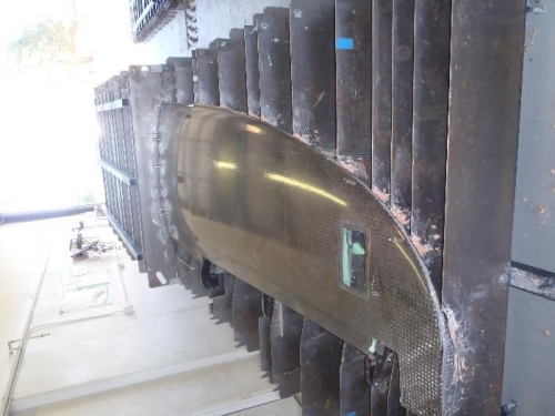

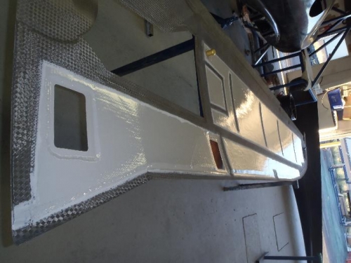

Installed both wing top halves in the Jig. Cleaned and prepped all contact surfaces. Applied 4212 grams of hysol for each wing 8424 grams total. Installed both wing bottom halves, Installed top of jig. Cleaned squeeze out. Smoothed radius on trailing edge squeeze out.
bottom skin prepped and ready
wing closed

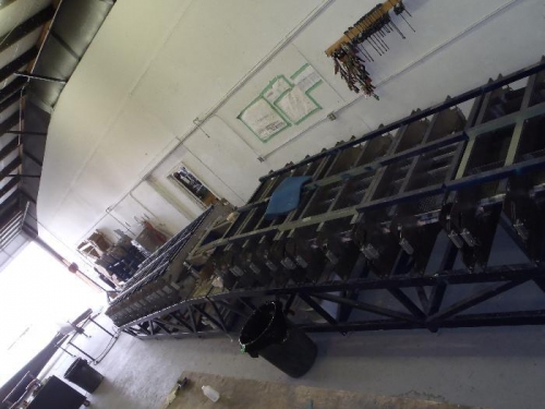

wing closed
Both wings complete in the Jig curing.
