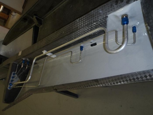

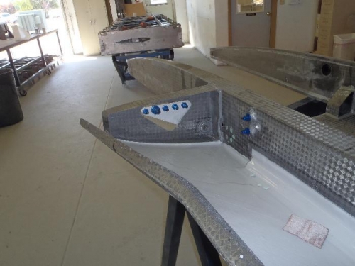

Installed fuel pickup tubes in both wings (finger screen). All 10 tubes (5 for each wing) were bent, nutted and flared as required to fit wing structure and nylon mounts which were then pop riveted to the wing spar. These tubes were the 1/2"D fuel feed lines, the 1/4" fuel return lines, and the 1/4" gear up, gear down, and brake hydraulic lines.
left wing before
left wing before
left wing after
left wing after
right wing complete
right wing complete
