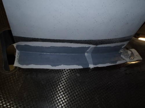

Installed 2 ply 4 inch wide re-enforcement lay-ups on bottom of horizontal to fuselage on both sides.

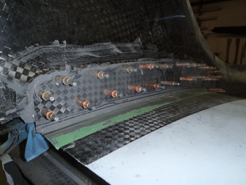

Trim to fit and installed top horizontal re-enforcement plates with hysol.
2 ply carbon fiber
top plate
bonded in
