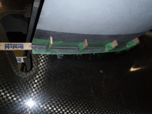

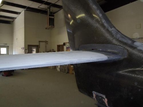

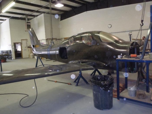

Installed wings in order to obtain level airplane. Leveled wings left to right. Leveled fuselage fore and aft. Slid Horizontal into mounting area. Aligned angle of incidence, left and right distance from vertical and aligned wag. Once all measurements were correct we installed alignment paint stick with super glue so it will slide back in the same spot. Recorded measurements and removed elevator for prepping and cleaning.
Wet out prepped areas with hysol. Piled hysol in vertical. Slid horizontal in place. Applied lead shot bags for weight to ensure good bond. Verified measurements and installed alignment sticks on opposite side.
first time assembled wings were mounted.
dry fit, taking measurements
all glued up.
all glued up.
