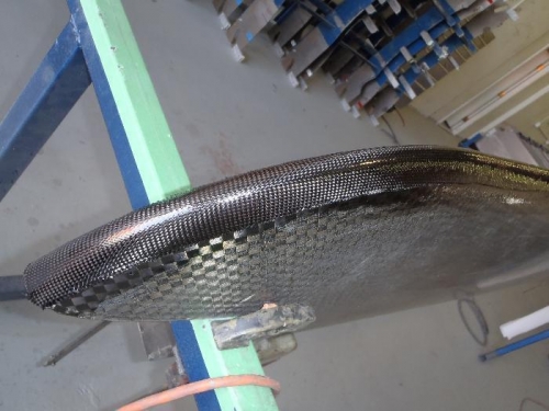

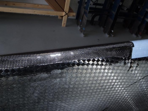

Sanded filler from the leading edge. Wet out a 2.5" wide 2 ply carbon fiber layup. Installed the re-enforcement layers on the leading edge of horizontal. Applied Peel-ply.
wet layup
peel ply for a smooth cured surface
