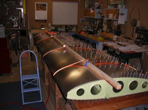

Used Don and Sharon Halls method of forming the LE edge skin over the nose ribs using 4 ratching cargo straps as shown. This worked very well, I didn't have any trouble at all. Hey it looks like a wing!
4 cago straps and a 2 by 2 draw down the LE skin

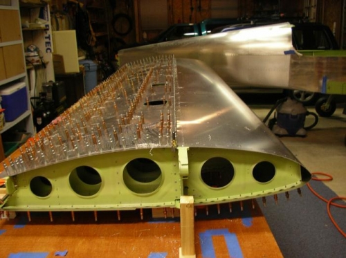

2 by 4 blocks on the rear spar to protect the trailing edge of the skins

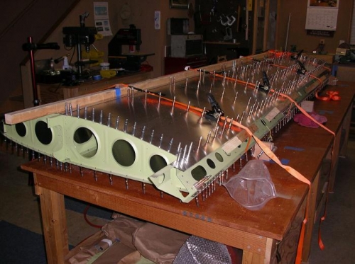

Drilled the LE skins to front spar #40
