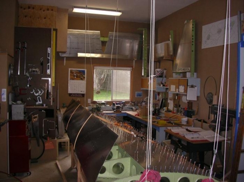

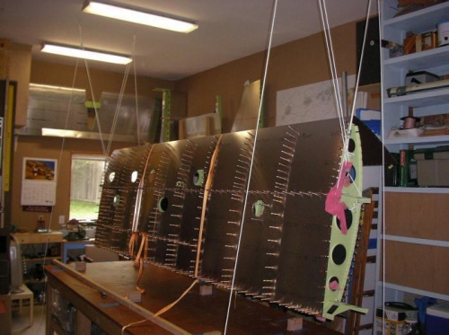

Turned wing top side up
Used a set of pullys suspended from the ceiling to turn the wing over by myself. Used 8 pullysand 4 lines to front and rear spars at each end. Reset the wing on blocks, ready for forming the leading edge skins over the nose ribs.
Turning operation half completed
wing safely back on the table
