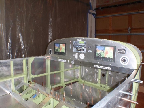

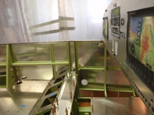

Brief Description:  Fit-up of fwd to aft fuselage
Cleco'ed the Fwd fuselage floor to the Center Fuselage spar stiffeners. Fit the fwd side skins to the frames upper longerons and center side skins. It all fit perfectly, a little to perfect so I trimed the fwd edge of the upper longerons a little more to eliminate a hard riding condition common to the firewall, there is now a 1/16" gap. Drilled the upper longeron to #40 c/t the side skins, engine fittings and firewall gusset.
Fwd side skin and upper longeron
Frames and floor beams fit perfectly
