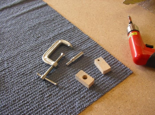

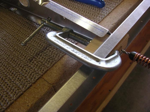

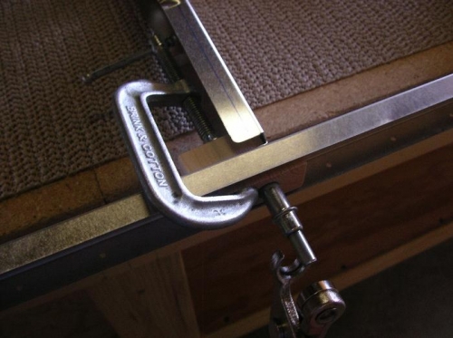

Drilled Frame out to full size. To keep the frame aligned while drilling where only one fastener holds two parts together, I made two clamp blocks, one with a hole big enough for a cleco to fit through and the other with a hole bigger than the final drill size. The parts are clecoed thru the first clamp block, then a C clamp is applied using the second block over the cleco teeth and tightened. Then the cleco can be removed and the part drilled, while the parts remain clamped tightly together.
Clamp blocks
Clamp blocks
Aligned with a cleco and clamped
Drilled
Drilled
