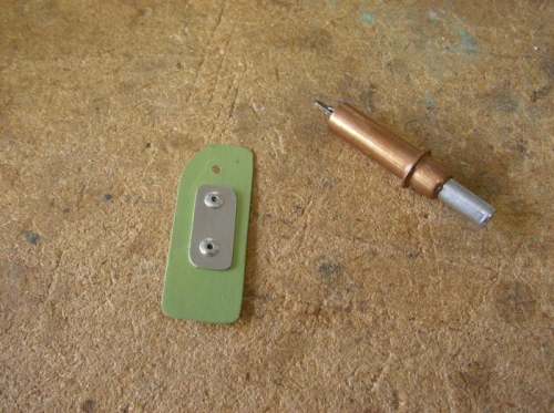

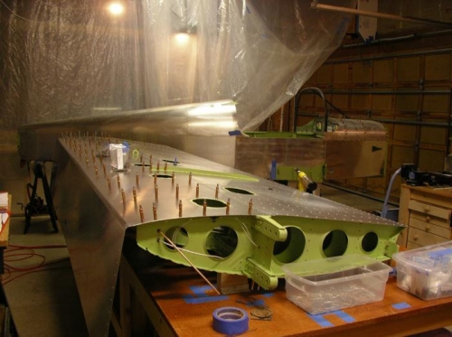

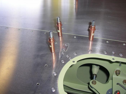

Fabricated a flush repair plate to close out the Rans installed hole in the leading edge skin for the pitot tube, and pluged the holes in the spar fore the pitot mast. I will be installing a Dynon pitot on the right wing with a new Rans pitot mast that attaches to a LE access cover. Then riveted the lower aft skin and aft rivet line of the leading edge to the wing frame. I used AAPQ-24 rivets in the fuel tank panel where in areas where AVEX rivets were called-out for additional strength.
LE skin plug
LE skin plug
plug installed
plug installed
Lower aft skin riveted in place
