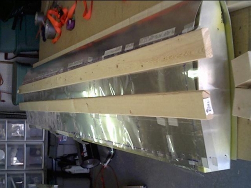

Brief Description:  Stabilizer - drilled top skin using template
Took the clear film off the skeleton and taped to skin alignment marks that wre made previously and then clamped down the skin tight using ferring strips and ratchet clamps. Started drilling top half of skin. Everything lined up nice.
My Dad stopped over about halfway through.
Stabilizer with clear template on skin and ferring strips ready to be clamped down for drilling
