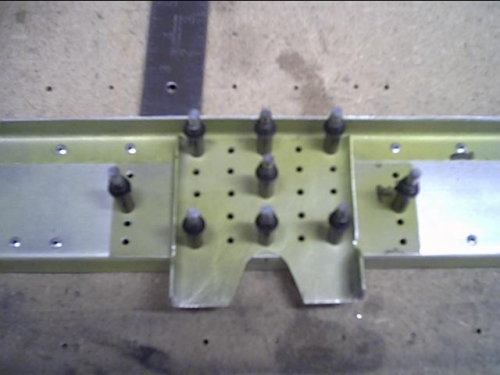

Brief Description:  Stabilizer rear attach plate
Fabricated rear attach plate and front attach angles for stabilizer. Time consuming. The rear attach plate is kind of a complicated piece and made out of .063 so it takes a little more to work with. Had to make two before I got it right. Laid out and drilled rear attach plate to rear spar. Deburred primed. Laid out entire assembly for general fit.
Stablizer attach plate clecoed to rear spar of stablizer
