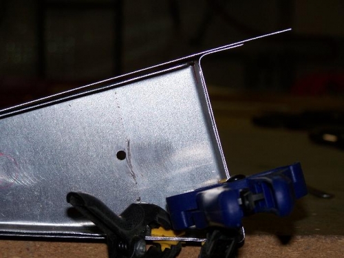

Brief Description:  Aileron

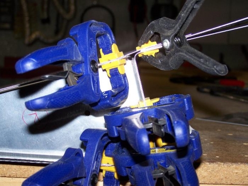

Finished acute bend in aileron skin. Took some pix of the hinge attach area. Looks pretty good, just want to get some opinions on Matronics list. The skin is 94mm top to bottom at the front per the plans, the rib appears to be about 1mm short. Still, all clamped up it looks acceptable.
Clamped up with spacer to simulate the hinge thickness.
No clamps before bending out the rib flanges to exactly 90 degrees.
With metric ruler in place. Top of bottom flange is 94mm.
