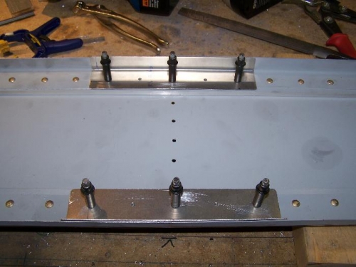

Added bridge piece of .032 across seam of spar caple angles along with other wrap-up items for prepping for skin.

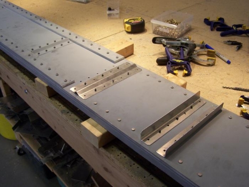

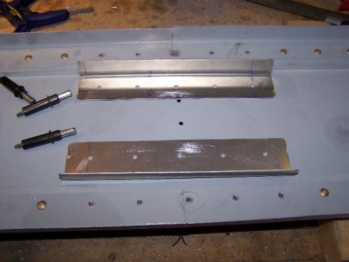

Moved nose rib angles and hats to fit a 15 gallon fuel tank in each wing instead of the standard 12 gallon tank.
Bridge pieces for cap angle splice
New locations and hat and rib angles for larger fuel tank
