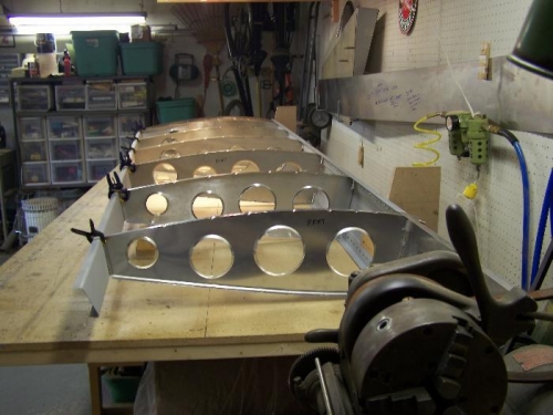

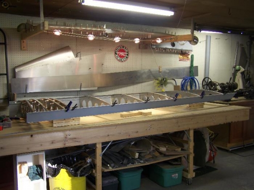

Right wing skeleton
Right wing skeleton
Wing skeleton from outboard (right) side.

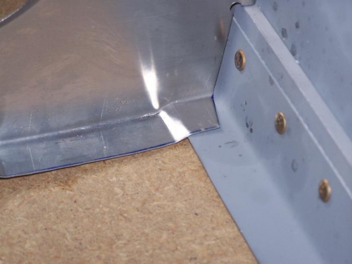

Another joggle. NOT the one I sheared. Little tighter radius than I like but OK.
