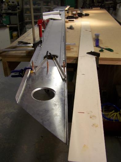

Did some research this morning and found on Dave Clay's website a picture of his center spar and it had the cutout allowing for the spar to move up further and allow the hole layout to line up properly.
Cut the used flange away and tried it. Line up perfectly.

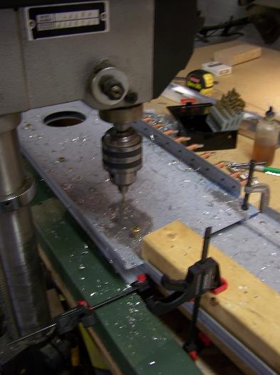

Set about drilling the wing attach bolts with the correct dihedral. Reamed holes to 5/16 inch. Nice fit. Craig stopped by several times and helped me set up and move the assembly around the other direction for drilling once the first side was done.

Setting dyhedral. When the straight edge is raised they touch.
Drilling main bolt holes.
