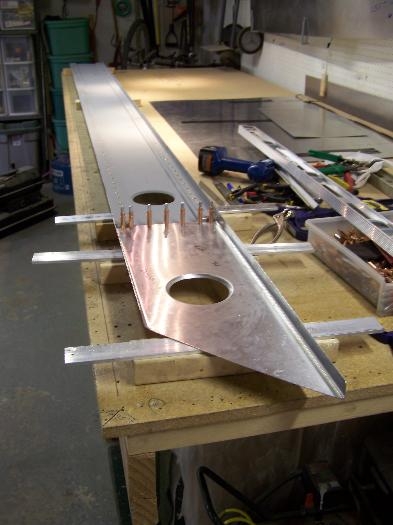

Finished setting A6 rivets to correct head diameter.
Fabricated spar tip and temporarily assembled on spar.

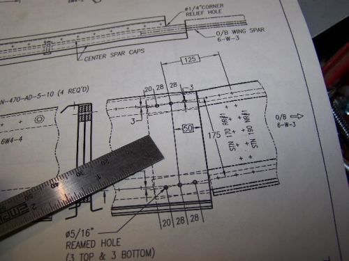

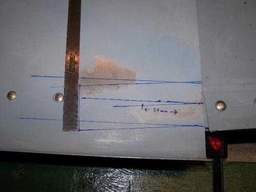

Set to work setting up dihedral for connection of center spar to main wing spar. Craig came over and gave me a hand figuring the best way to do it, measured, remeasured, starting seeing that the bolt layout on plans didn't match reality. Looked like the spar needed to move up about 5mm to get the center bolts top and bottom on the centerline of the center and right wing spar lines. They were lining up with the outboard most bolt lining up with the centerlines and the inboard bolts off mark putting the inboard most bolt dangerously close to minimum edge distance if not past it. Wasn't happy. Seemed like the web needed to be cut out more but the plans didn't call for it. Figured I'd sleep on it.
