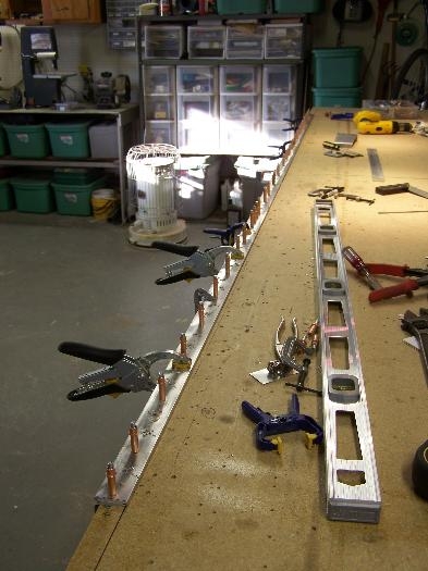

Brief Description:  Adjusted spar cap angles and drilled

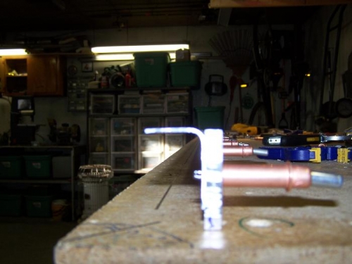

Check the angles on the spar cap angles and made minor adjustments to conform to plans. Tweaked crimped flutes in one outer spar cap angle so that it laid flat on the table. Then I set up the angles flat on the table with the proper gap (5.5mm) for the bottom cap angle in relation to the spar cap, clamped the assembly to the table and drilled holes in the cap angles using the lower spar cap as a holes template. I then repeated the process for the upper spar cap and angles using a .5mm gap between the flange of the angle and the top of the spar cap per the plans. I then deburred all the holes.

Set up and drilling of cap angles for spar caps
Looks pretty damn straight. Glad I beefed up the big brake to bend the .040 properly.
Nice looking .5mm gap between top of cap angle and top of spar cap. Extends entire length nicely.
