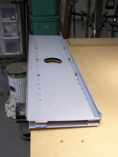

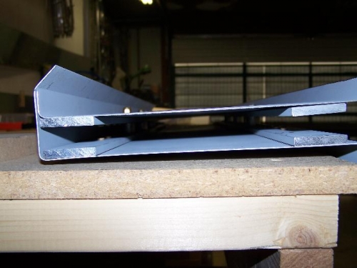

Cleaned up garage after last session. Riveted center spar. Neighbor Craig helped me hold setup up to bucking bar. Bar slipped a bit occasionally and caused riveter to make c-moon cuts on rivets heads. These will need to be removed and reset. Test fitted to halves to form full center spar assembly. Forgot to leave 4 rivet holes open for angles that fit top to bottom across center spar. Made angles, laid out rivet pattern and clecoed to center spar assembly.
