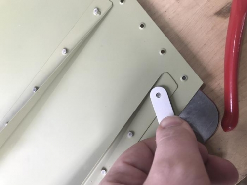

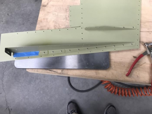

Attached R1003A to the L rudder skin using -3 rivets AND leaving the last three holes open.
Attached R1003B to the R rudder skin using -3 rivets AND leaving the last three holes open.
Checked all rivets with rivet gauge to ensure properly set.
