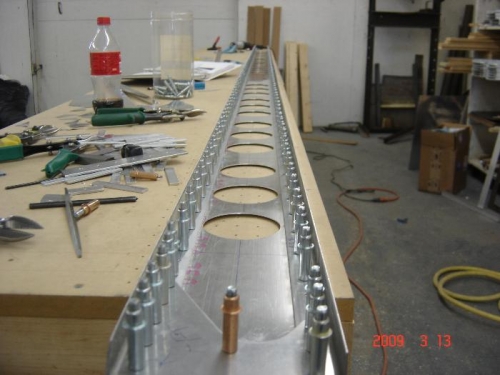

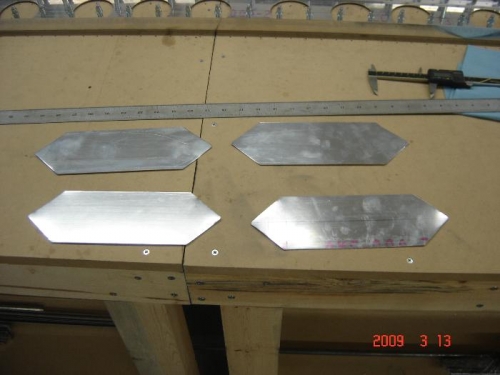

I made the rear spar splice plates and then pre drilled them all together so they would match up. I then drilled out the right spar caps and webbs with #30 drill bit for the 4 rivets. I pre drilled the spacer bars that go between the spar caps.
The rear spar splice plates
Right rear spar with front and aft cap strips ready to drill with #30 drill bit
