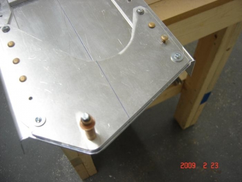

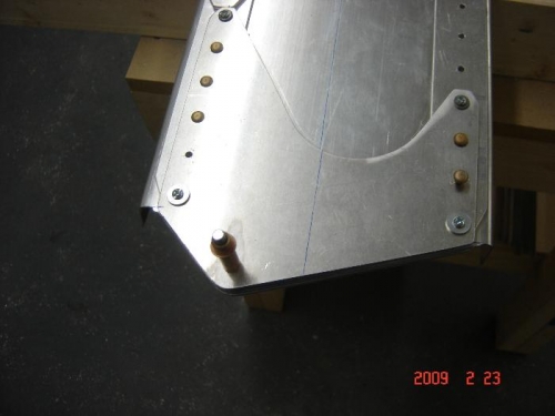

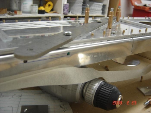

I finished match drilling the strut attach bar to the spar and marked the side of the web for where the strut attach bar passes through the web. I then drilled a hole in each end of the slot. I need to borrow my sons dremel tool to finish cutting it out. I then marked the end of the web where the spar attach plates are and then trimmed them to shape. This was all for the left main spar and then I marked the right main spar for trimming it.
Marked for strut attach bar pass through and drilled the ends
Ruff cut out of web on attach plate end
