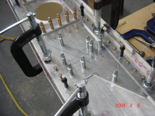

Brief Description:  Match drilled spacer bars to right main spar web
Drilled and clecoed spacer bars to right main spar. Marked out and predrilled some of rivet holes in web splice plate. Marked rivet holes and predrilled filler plate for main spar strut attach bar.
Spacer bars drilled and clecoed
predrilling web splice plate
